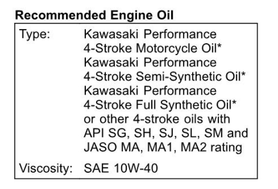

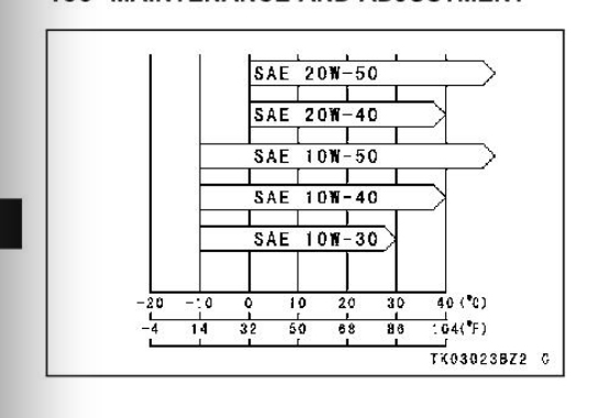

    Here is an example of Kawasaki's motor oil recommendations in the owners manual for the 2019 Kawasaki Vulcan 1700 Voyager. Notice they say to use motor oil that meets JASO and API standards when switching to another brand. Also notice their viscosity chart for different ambient temperatures.
    Recommended oil for the 2019 Kawasaki Vulcan 1700 Voyager
    Kawasaki recommended oil viscosity for different ambient temperatures

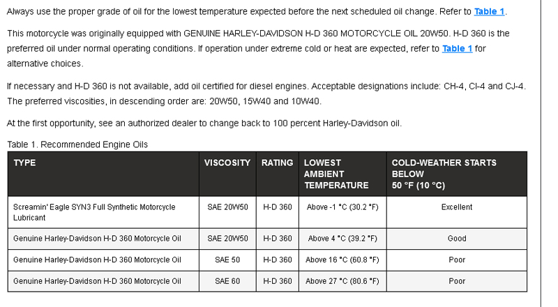

    Harley Davidson does refer to API ratings when making recommendations for switching to other oil brands in an emergency, but the API ratings are for diesel oil (see image below). Harley Davidson doesn't say why they recommend using an oil formulated for diesel engines and I don't know the answer. It makes me wonder if Harley Davidson Syn3 and HD360 oils are actually formulated for diesel engines and this is the real reason Harley doesn't bother getting API or JASO rating for their motor oil?

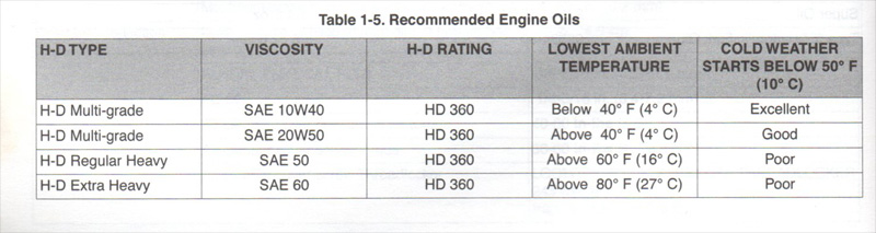

  • Harley Davidson motor oils are only available in 20W50, SAE 50 and SAE 60 oil viscosity. Harley Davidson discontinued their HD360 10W40 motor oil and changed the oil recommendations for newer Harley Davidson motorcycles. I don’t know when this change occurred, but I assume it was around the time they started selling a full synthetic oil. The old recommendation was to only use 20W50 motor oil in ambient temps above 40F. The new recommendation is to only use 20W50 Syn3 in ambient temps above 30.2F. The old recommendation still applies to the HD360 20W50 conventional oil. If your riding in cold weather with temperatures lower than 40F, and own an older Harley Davidson motorcycle, then it’s possible your owner or service manual is using the old recommendations. I’m sure most Harley Davidson riders won’t attempt to ride in temperatures below 40F, but what if you want to and don't want to pay the higher price for a full synthetic oil. You'll have to get your oil from a place other than Harley Davidson.
    I don’t think most Harley Davidson techs are even aware of the oil viscosity change, and you can forget about contacting Harley Davidson customer service for answers, because they will just direct you back to the dealership. I don’t think there is a way for most people to contact Harley Davidson engineering for the official reason for changing the oil recommendation chart. I have no idea if Harley Davidson applies the new oil recommendations to older Harley motorcycles. They probably do and will say full synthetic oil is the reason for the change.
    If you want to use 10W40 in your Harley motorcycle for cold weather riding, then you need to change to another brand. I’m sure most Harley dealerships will allow you to bring in your own motor oil to use when your bike is serviced. Both Valvoline and Mobil 1 sell a 10W40 motorcycle oil.
    This chart is from a Harley Davidson service manual for 2008 touring motorcycles
