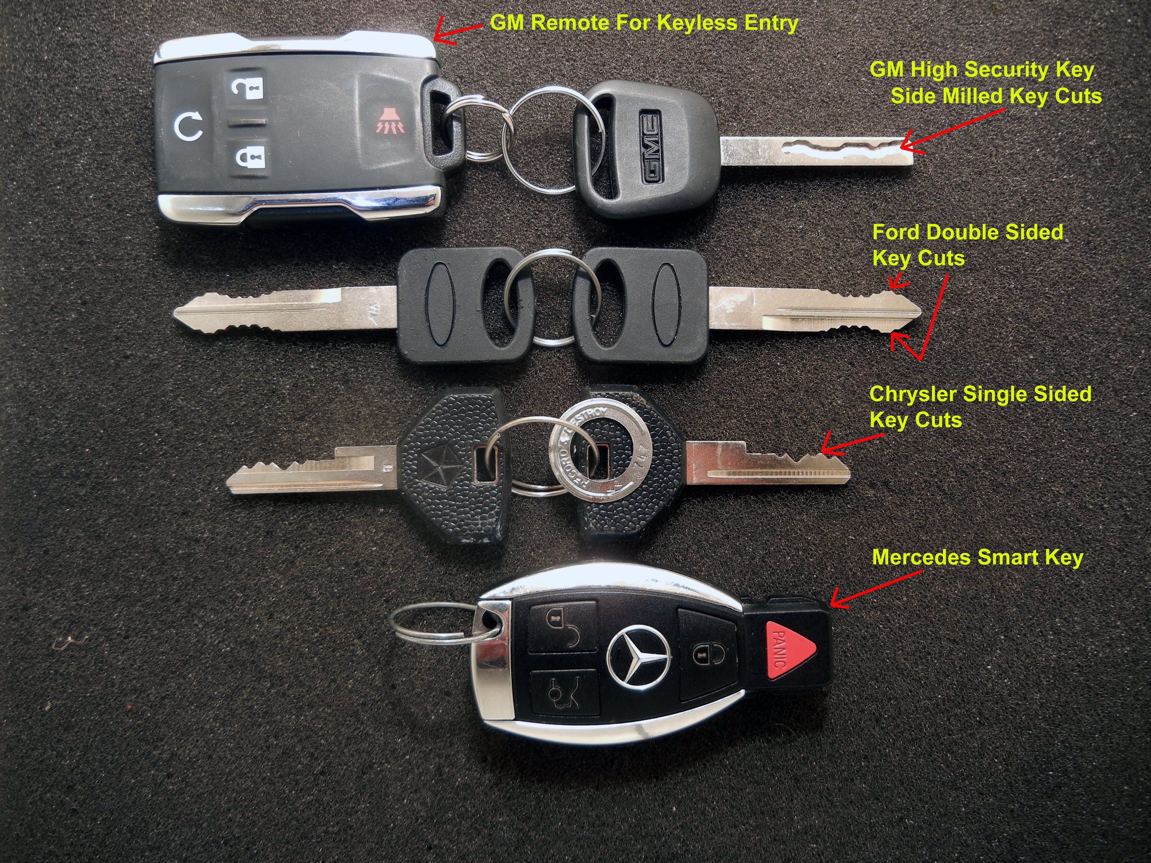

The first key is GM high security key with cuts milled into the side of the key, and a keyless entry remote. There is a transponder chip embedded in the key head or bow. The second key is a Ford double sided key with cuts on both edges of the key. It is a regular key with no transponder. The third key is a Chrysler single sided key with cuts on only one edge of the key. It is a regular key with no transponder. The fourth key is a Mercedes Benz smart key that is also a keyless entry remote.

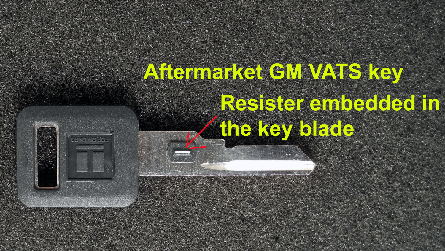

This is an aftermarket VATS key for GM vehicles. This key is a single sided key, but they also make a double sided VATS key. You can see the resister embedded in the key blade.
