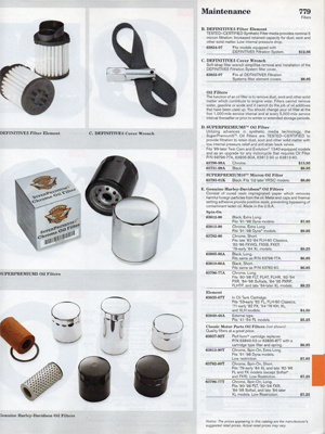

For those of you out there confused about Harley Davidson's "5 micron" oil filter statement and what exactly that means, rest assured your not the only one. The "5 micron" statement alone is meaningless without a percent efficiency rating, which they fail to mention on their website and other marking material produced today. You have to go back to a 2008 Harley Davidson Parts and Accessories catalog to find the 5 micron statement labeled as nominal rating.

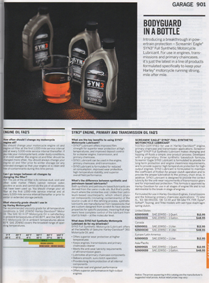

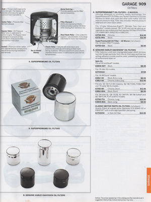

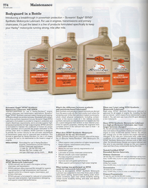

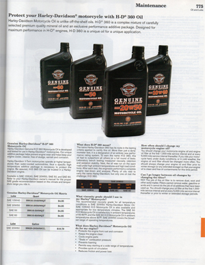

Here are some pages I scanned from 2 different Harley Davidson Parts and Accessories catalogs. One catalog is from 2008 and the other is from 2017. The SYN3 synthetic oil Harley Davidson sold in 2008 was actually a blend, but they never used the word blend or full in marketing material. The oil filters look the same in 2008 as they do in 2017, but they may have changed oil filter manufacturers. I'm not sure. I couldn't find any mention of the 5 micron statement being a nominal rating in the 2017 catalog.

2008 Harley Davidson Motor Oil
2017 Harley Davidson Motor Oil
2008 Harley Davidson Oil Filters
2017 Harley Davidson Oil Filters
