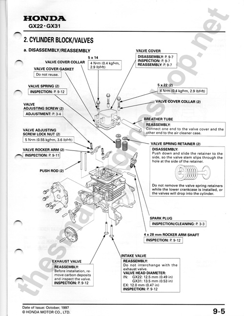

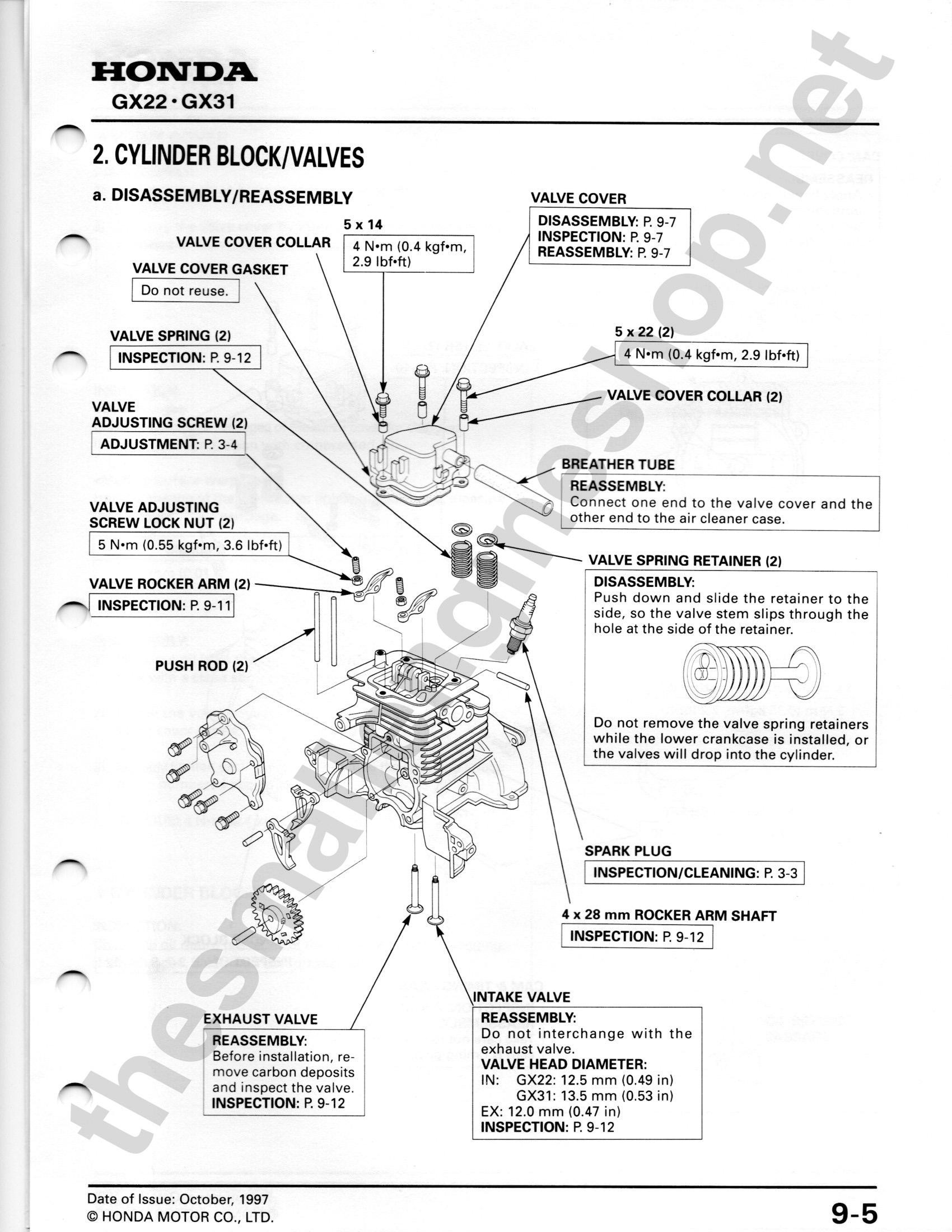

Honda GX31 Engine Diagram With Valve Spring Retainer Disassembly Instructions
March 08, 2019, 01:22:24 AM »
Click on image to enlarge.
