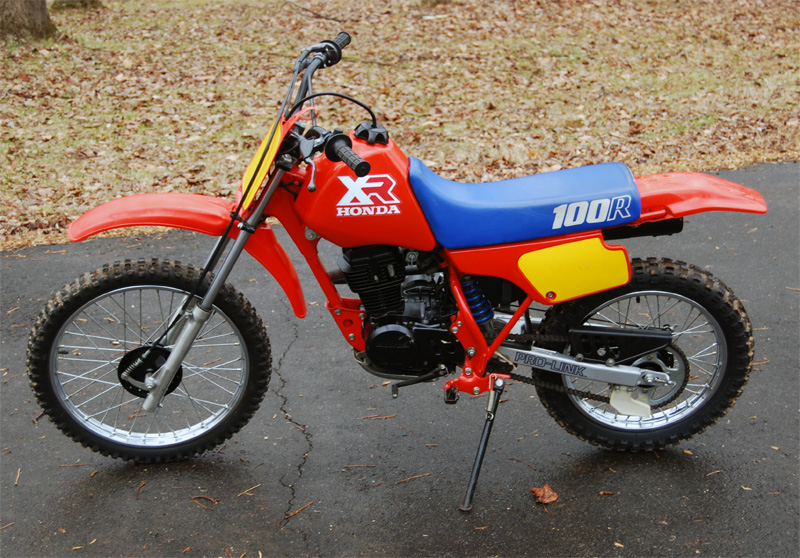

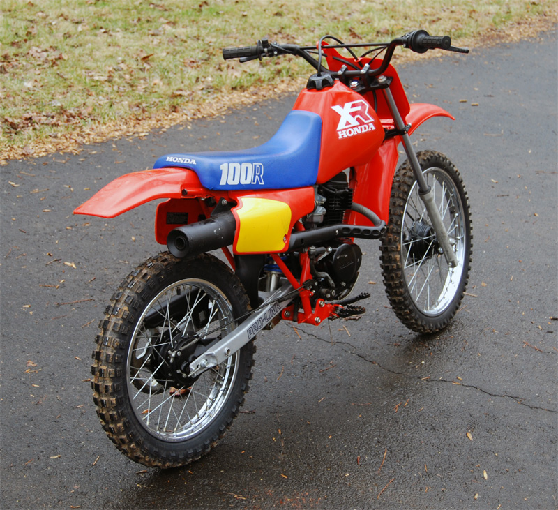

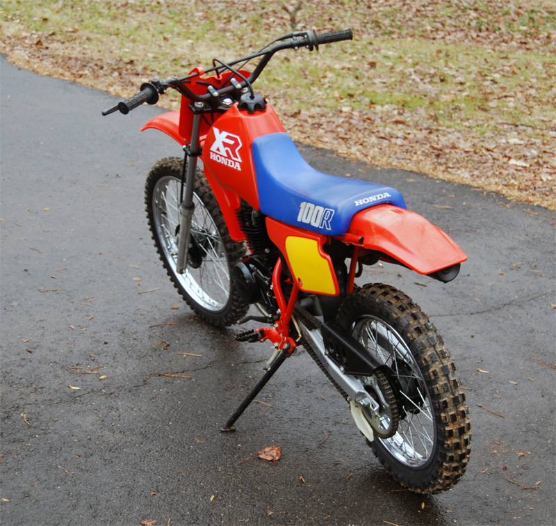

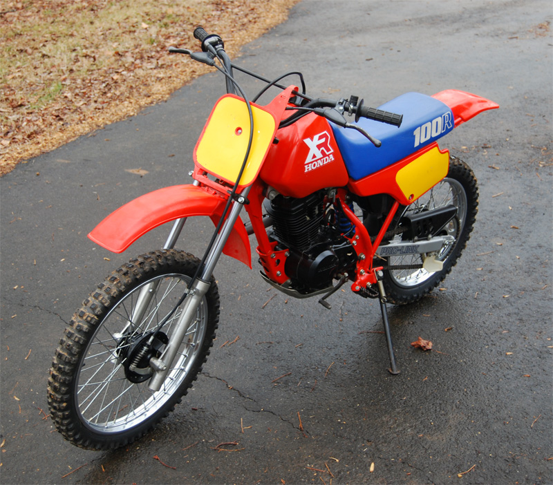

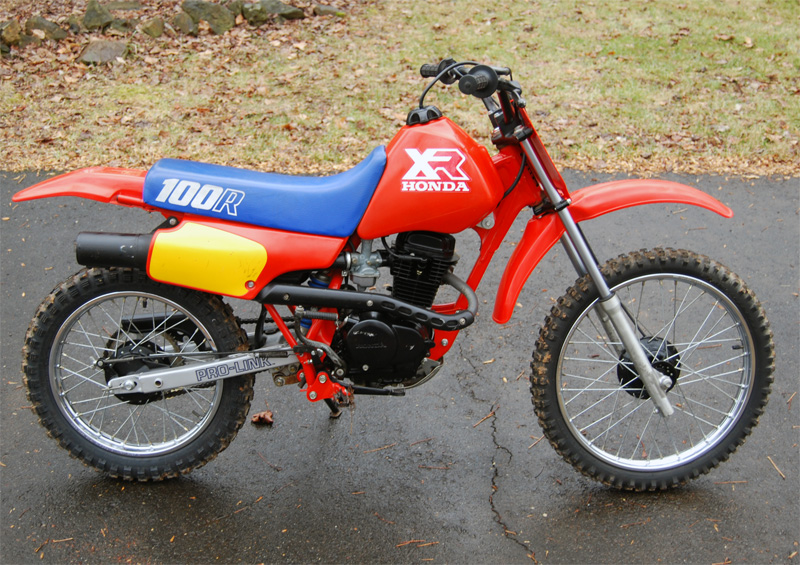

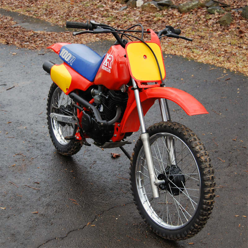

I just finished working on a 1986 Honda XR100R. The bike is in great condition, so I didn't do much to get it in good working order. I thought I would share a few photo's of this motorcycle with everyone, and post some of  the bikes specifications. Also I purchased a repair manual for the following Honda motorcycles: 1975-1991 XL/XR75, XL/XR80, XL/XR100, so if anyone needs any information from this manual, than post your request on this forum and I will reply back.
