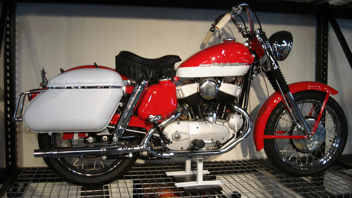

1952 Harley Davidson K model

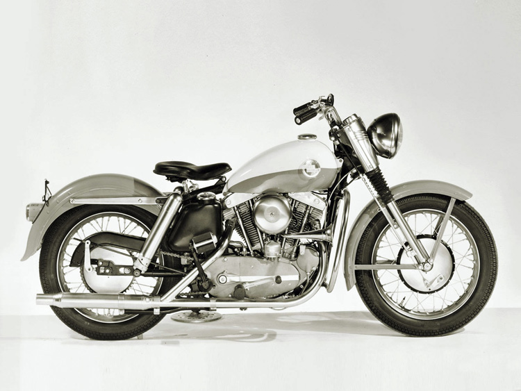

1957 Harley Davidson Sportster

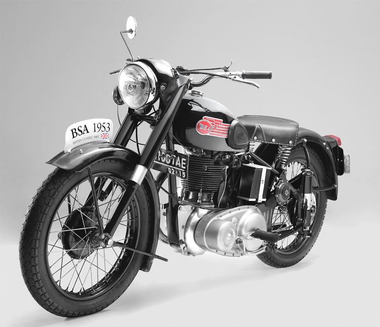

1953 BSA

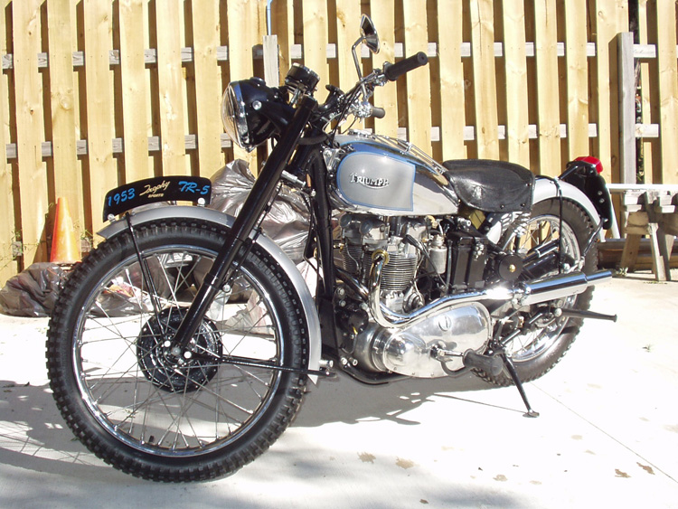

1953 Triumph Trophy
