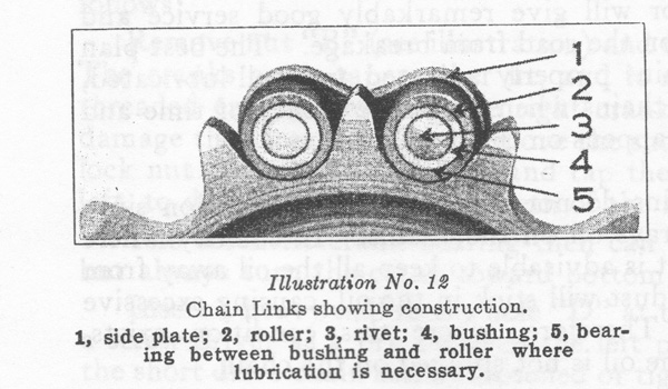

Below is a section taken from a 1917 Harley Davidson manual about chain lubrication. The section title is called "How to Lubricate the Chains."
"The drive chains, being of the roller type, must be kept well lubricated at all times. Refer to llustration showing sectional cut of chain link and where lubrication is neccessary.

The only way to lubricate chains properly is to remove tham from the machine, clean them thoroughly by placing them in an old clean pan or suitable receptacle, and covering the chains with plenty of kerosene or gasoline. Do not be satisfied with letting the chains soak a while, but move them around, "stir" them up, in other words, so that all the grit is removed from between the rollers and bushings. After the chains are thoroughly  cleaned in this manner the proper chain lubricant should be applied.
After taking the chains out of the lubricant, hang them up to dry allowing the extra lubricant to drip into the utensil used for heating the paste.
Use the Harley-Davidson chain lubricant for all conditions of service. This comes in the form of a paste and should be applied in liquid form, after heating. The lubricant should be heated as per instructions on the lable of the container, and the chains than placed in the melted lubricant for ten or fifteen minutes, so that it will have a chance to work its way in under the rollers while it is hot.
