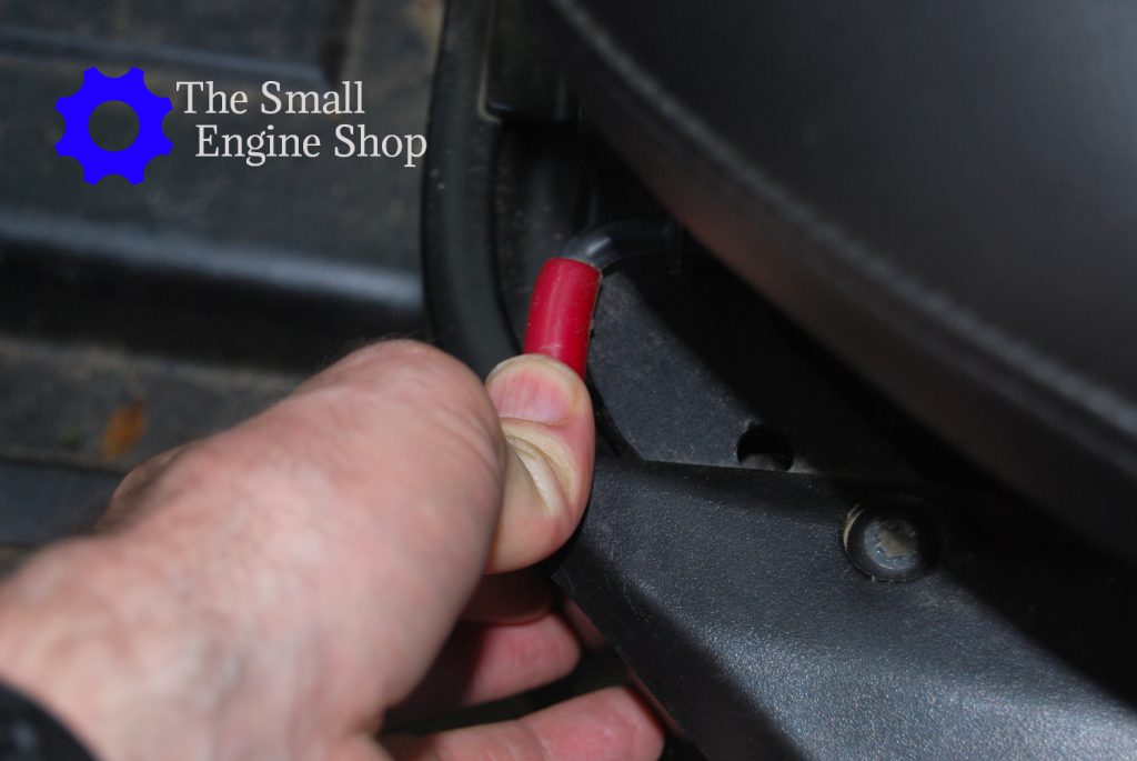

The seat must be removed to see all 3 T40 bolts that hold down the plastic panel hiding the battery. The spring loaded lever locking the seat in place is depressed before sliding the seat forward for removal.
