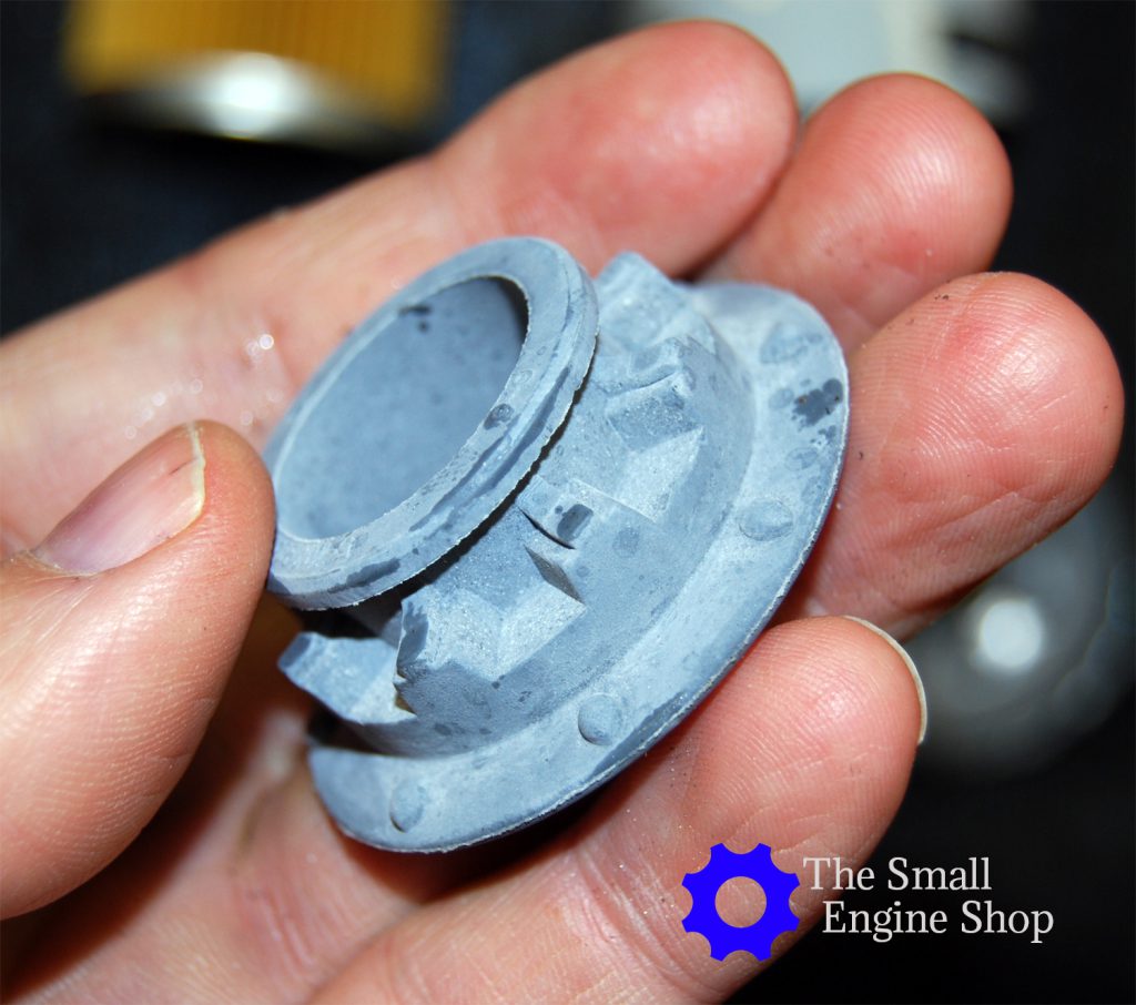

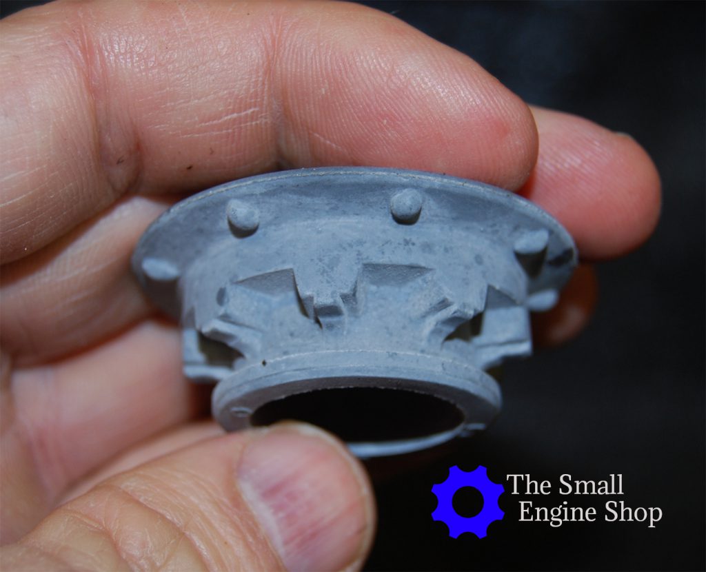

Walmart sells a line of oil filters manufactured by Wix under the Walmart Supertech label. All Walmart Supertech oil filters have a low price of $2.84 regardless of the filter size or application. I purchased a Walmart Supertech ST6607 oil filter to review because it is similar to the STP S6607 I reviewed earlier, and I have seen the filter recommended for motorcycle use. I am not sure how the filters performance rating compares head to head with say a FRAM Extra Guard other than the efficiency rating is lower, but more about that later. The filter consists of a paper filter element, metal end caps, nitrile drain back valve, bypass valve built into the drain back valve, base plate with 8 inlet holes and a white metal filter housing. The filter uses a weird type of rubber bypass valve built into the rubber drain back valve. See photos….. The bypass valve looks like a design used to cut cost and not a design for performance. I would be concerned about the Supertech ST6607 bypass valve allowing more oil to bypass the paper filter element under normal engine operation than the typical spring loaded bypass valve seen in better oil filters. I can’t find any specifications for this oil filter other than what is written on the oil filter box, and it doesn’t give a psi rating for the bypass valve.¬† However, it does give an efficiency rating that is a bit misleading.

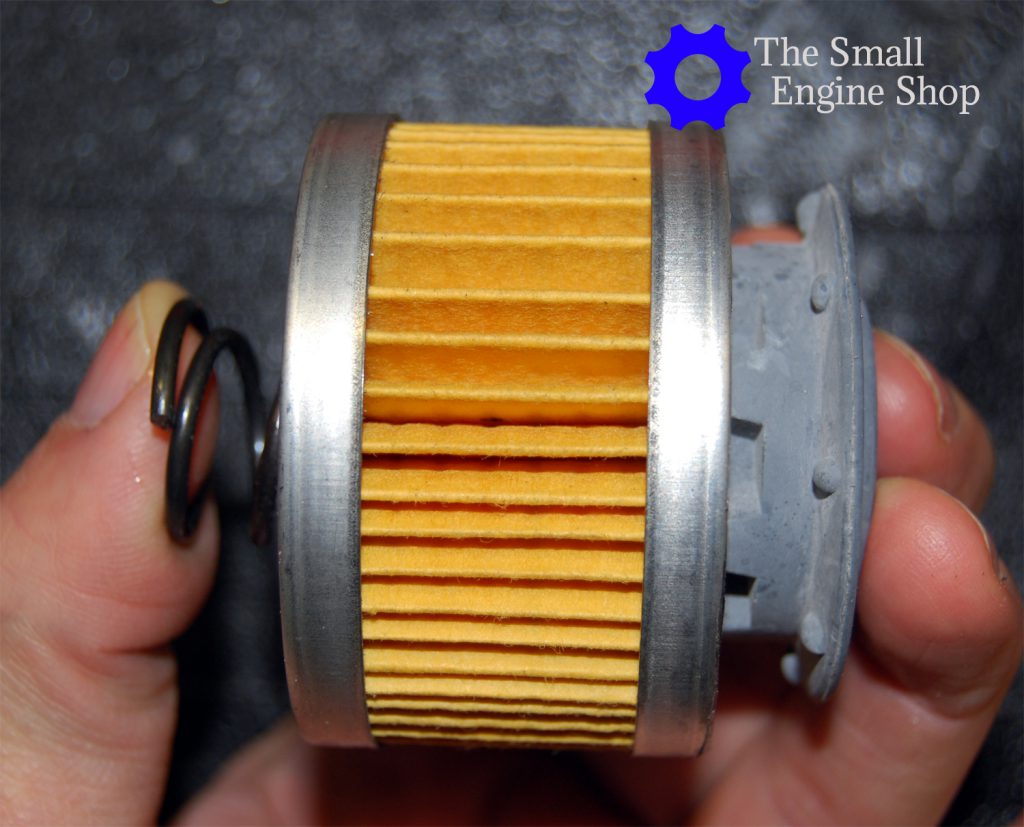

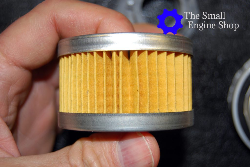

The Walmart Supertech ST6607 paper filter element and end caps. I didn’t see any openings in the paper or any openings where the paper is glued to the end caps. The paper filter had 49 pleats.

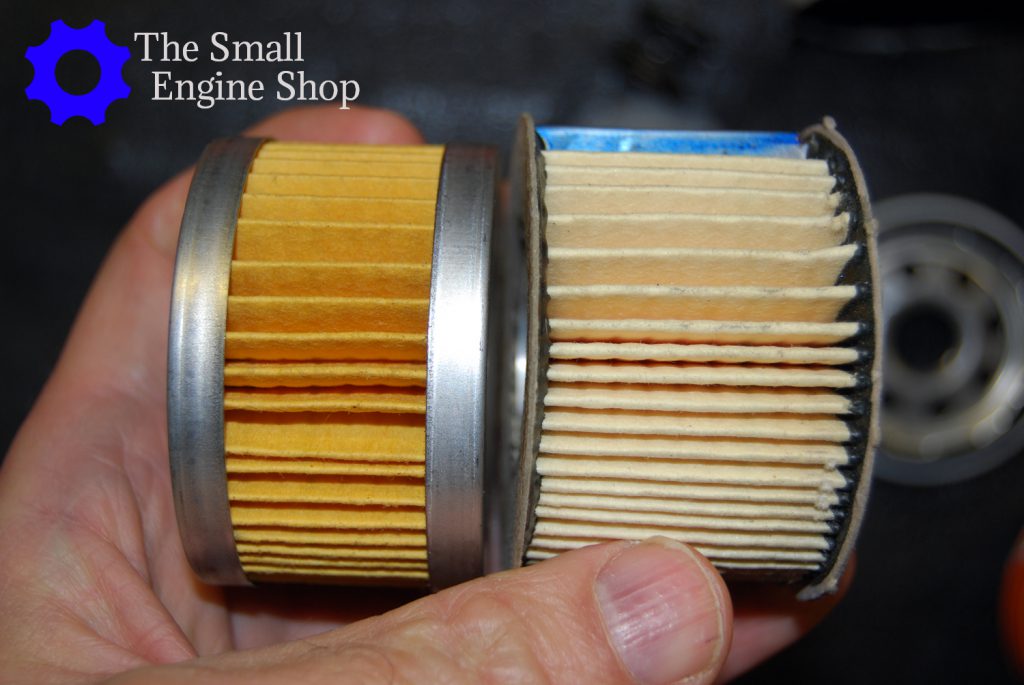

The Walmart Supertech ST6607 paper filter element end caps compared to the FRAM PH6607 paper filter element and end caps.

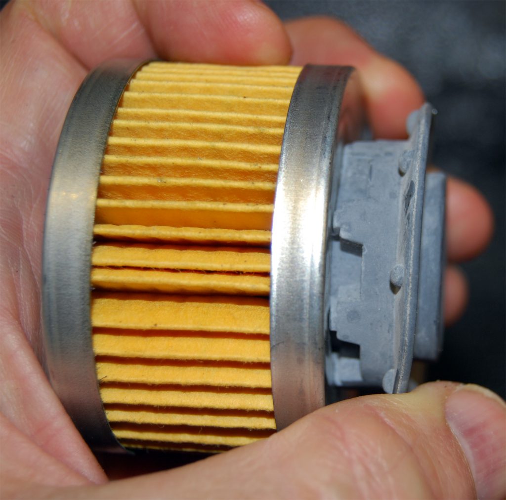

The Walmart Supertech ST6607 bypass/drain back valve and where it fits into the metal end cap.

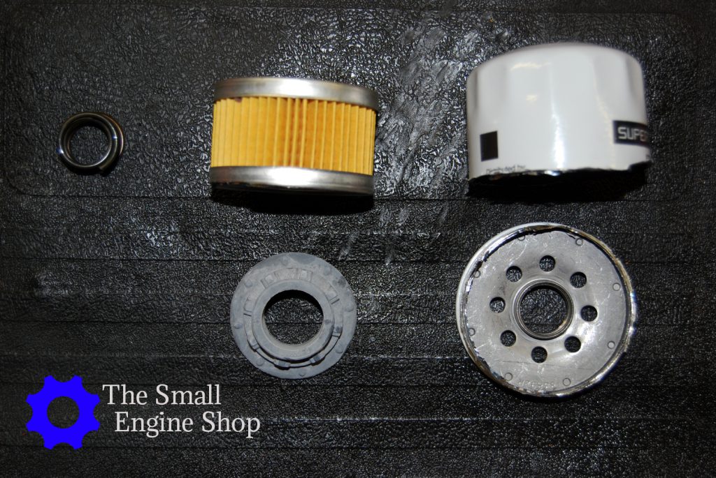

Walmart Supertech ST6607 oil filter internal parts all arranged in order and how it is arranged inside the oil filter metal body.

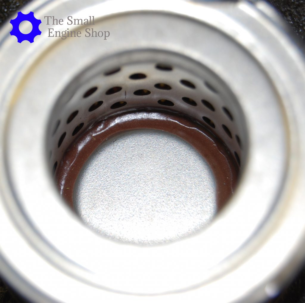

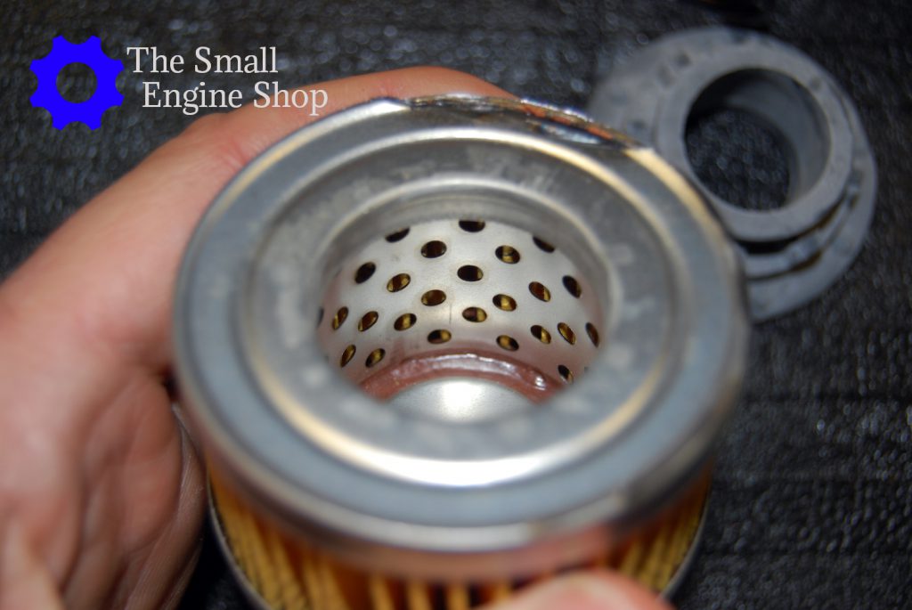

The Walmart Supertech ST6607 metal crush sleeve. This part fits inside the paper filter element and between the 2 metal end caps.

The Walmart Supertech ST6607 oil filter internal parts arranged on the mat. From top left to right: Spring that creates the pressure to hold everything tight, paper filter element and metal end caps, outer filter shell or body, nitrile bypass/drain back valve and filter base plate.

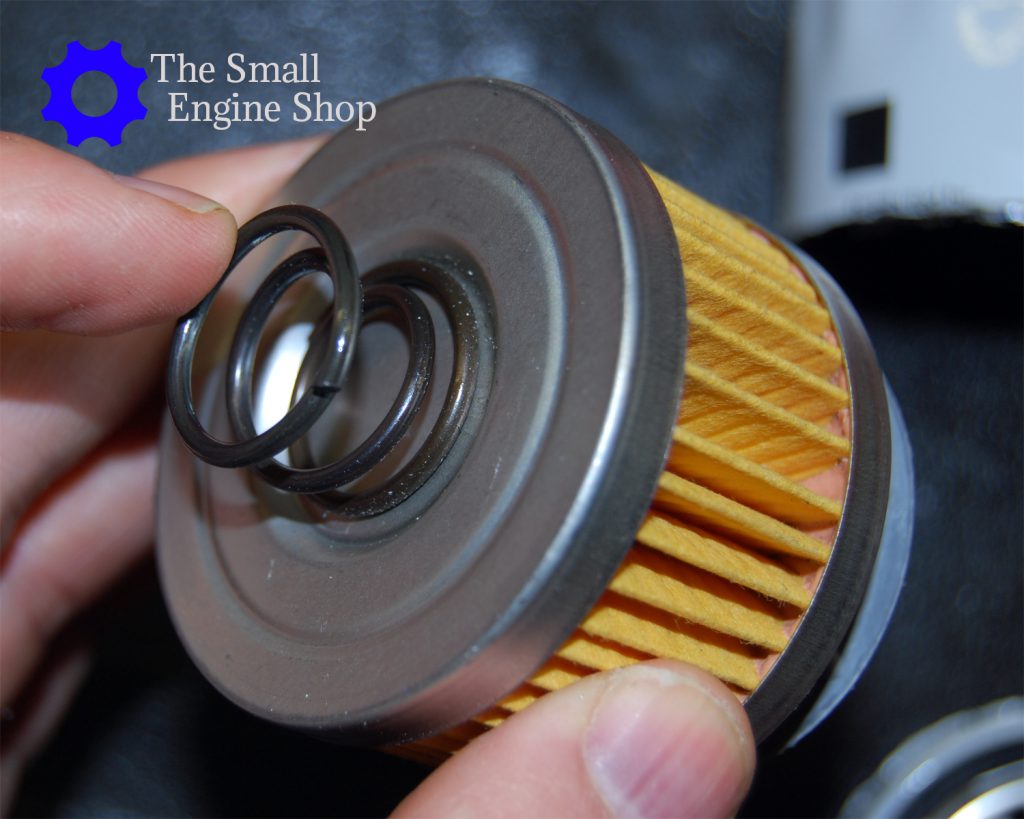

The Walmart Supertech ST6607 oil filter internal spring that creates the pressure that holds all the internal parts together.
Walmart Supertech ST6607 bypass/drain back valve. The part where my thumb is touching fits into the metal end cap. You can see the openings created in the rubber where oil can flow through and bypass the paper filter element. The other end where my index finger is is the drain back valve part. I believe it is a design meant to lower the filter cost.

Walmart Supertech ST6607 bypass/drain back valve. This is the drain back end of the rubber valve.

Walmart Supertech ST6607 bypass/drain back valve, metal end caps and paper filter element. You can see where the bypass/drain back valve fits into the metal end cap. The openings in the rubber valve closest to the metal end cap is where oil can enter and bypass the paper filter element. The only thing preventing oil from passing through here is the seal created by the rubber valve and metal end cap. I did feel a slight amount of side to side play between the rubber bypass valve and end cap when the valve was fully inserted into the end cap. This is not good because it has the potential of allowing oil to pass through the bypass valve when you don’t want it to.
