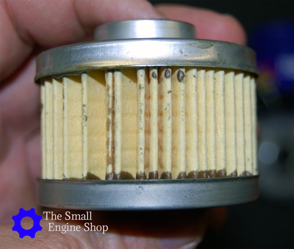

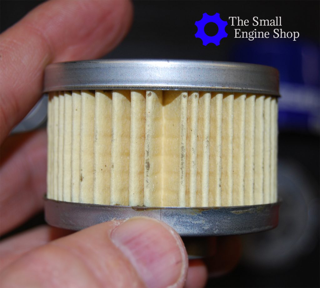

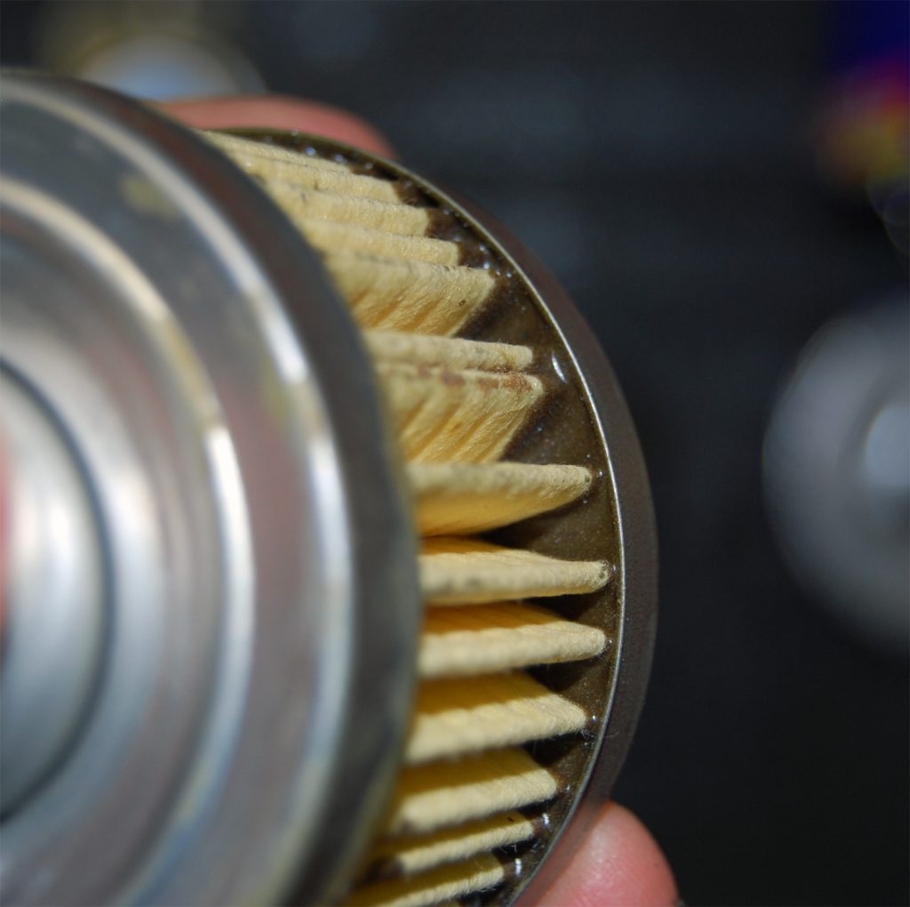

The STP Oil Filter S6607 paper filter element and metal end caps. You can see how unevenly spaced the paper filter pleats are, but this is common with low end oil filters.
The STP Oil Filter S6607 paper filter element, end caps and the glue used to attach the end cap to the paper filter.
The STP Oil Filter S6607 paper filter element and metal end caps. This paper filter element has 46 pleats.

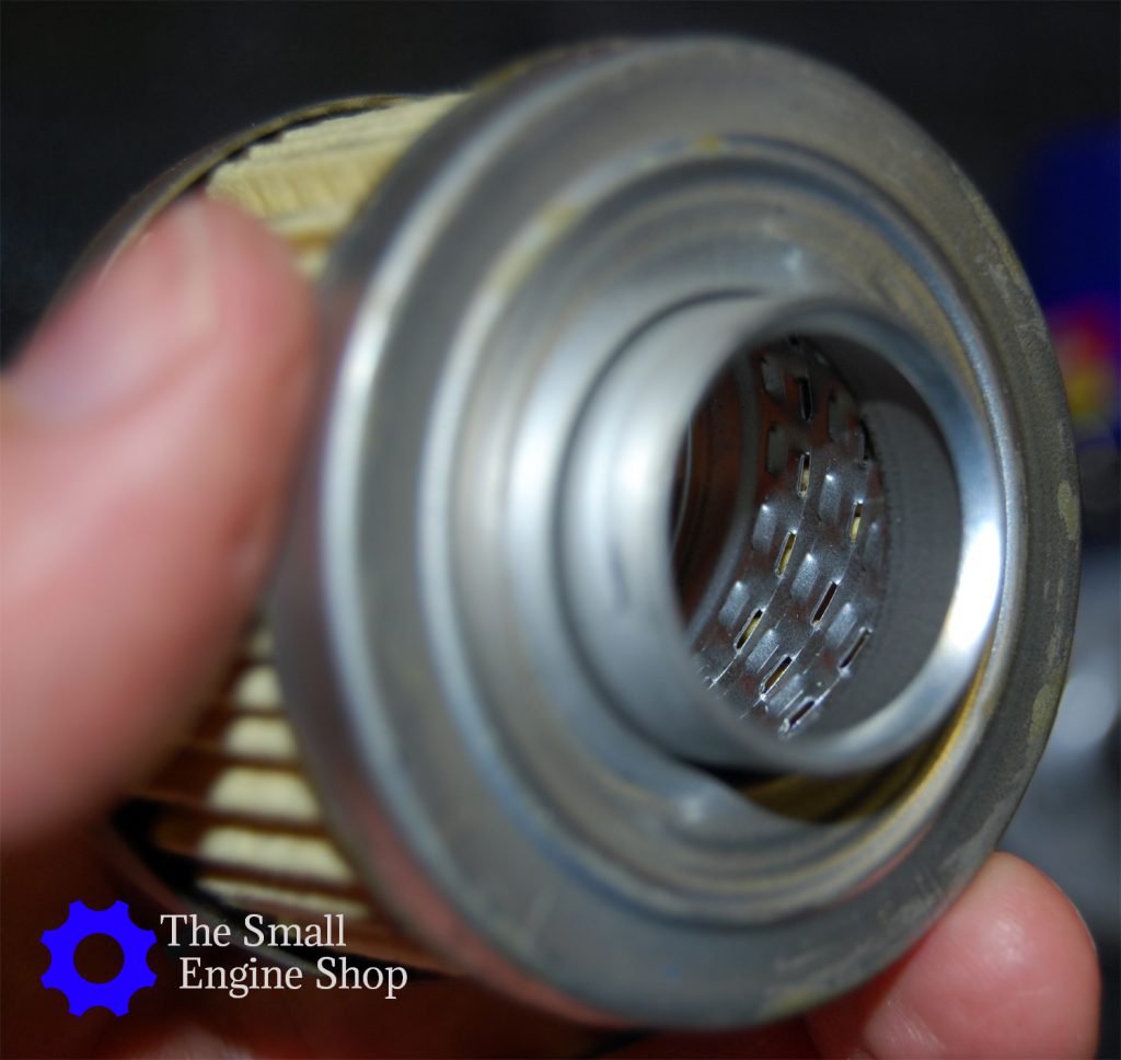

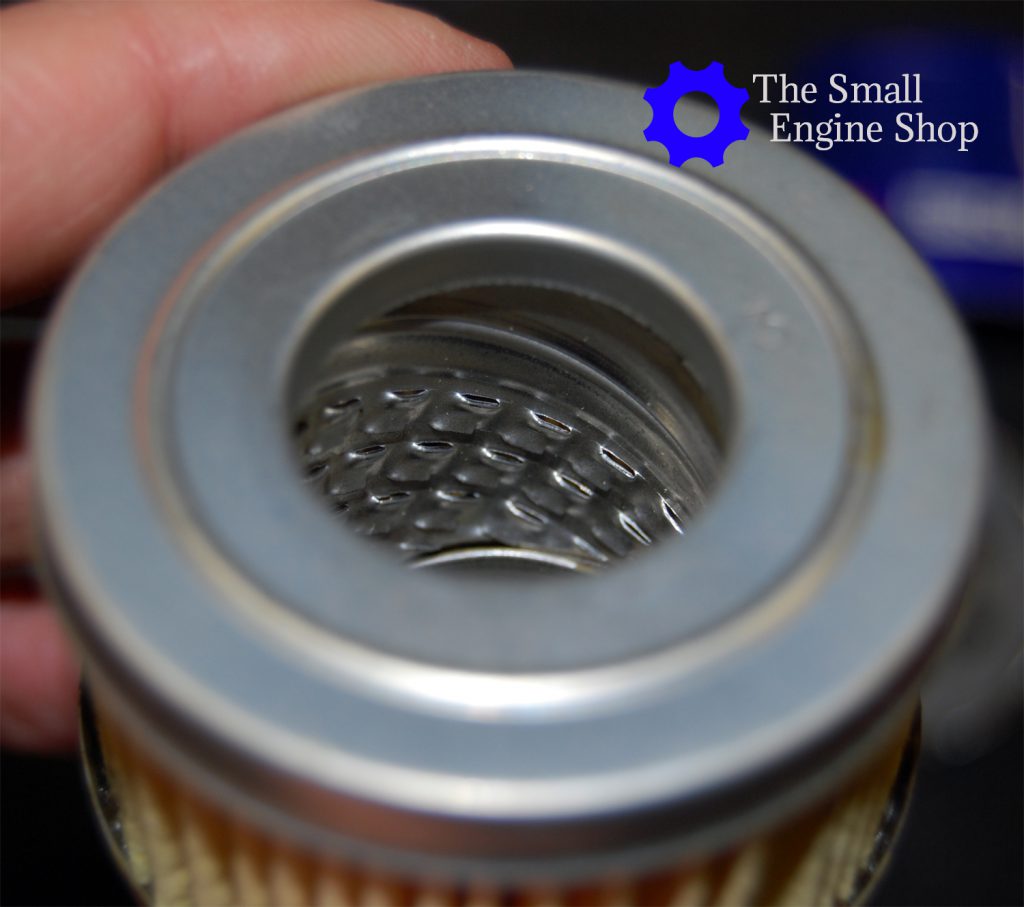

The STP Oil Filter S6607 metal end cap and metal crush sleeve. The bypass valve fits into this end cap.
The STP Oil Filter S6607 metal end cap and metal crush sleeve. The nitrile drain back valve attaches to this end cap.

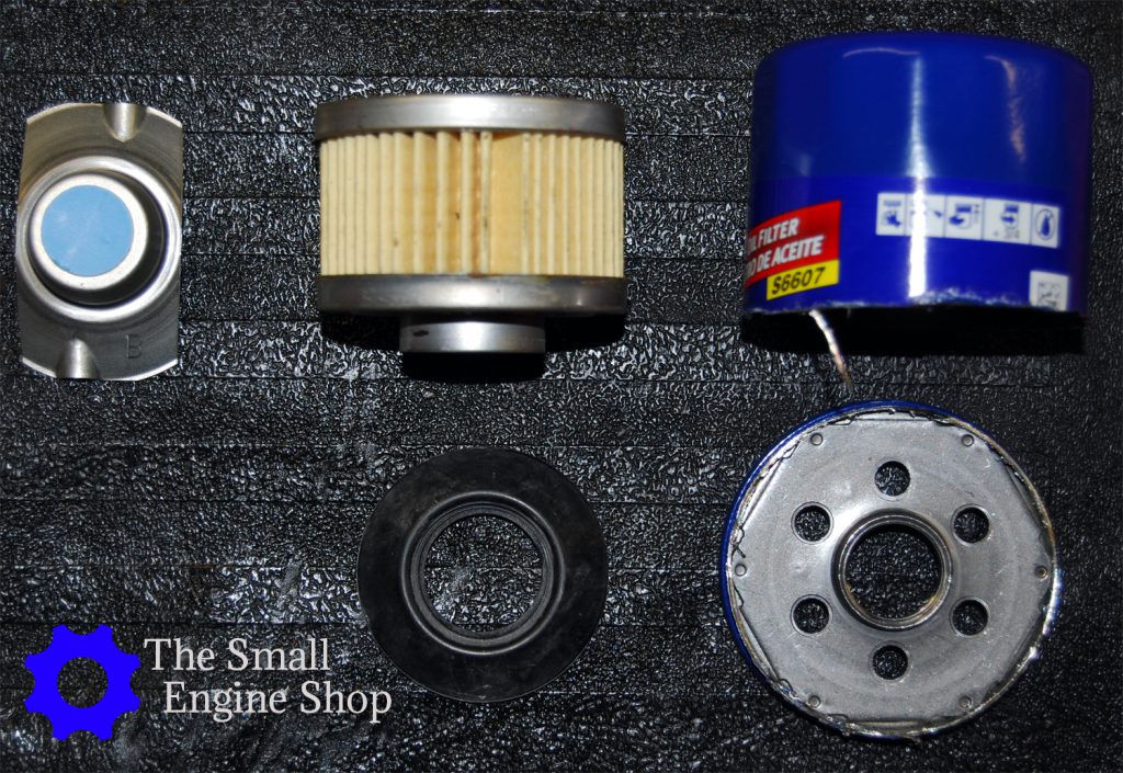

The internal STP Oil Filter S6607 parts. From top left to right: bypass valve, paper filter element with metal end caps, oil filter housing, nitrile drain back valve and base plate.

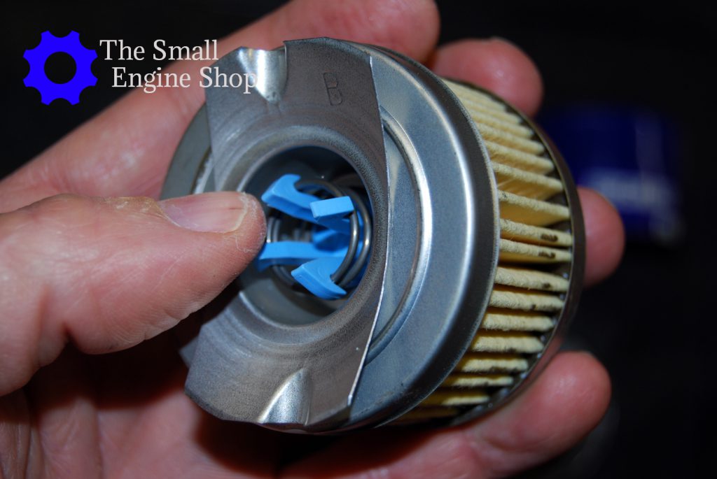

The spring side of the STP Oil Filter S6607 bypass valve. Notice how much this bypass valve looks like the bypass valve’s used in FRAM oil filters.
The STP Oil Filter S6607 bypass valve with the spring compressed and the bypass valve open.

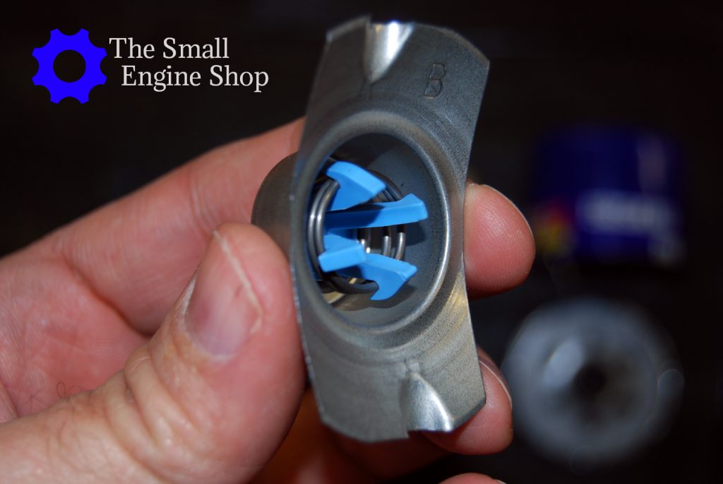

The STP Oil Filter S6607 bypass valve opposite the side with the bypass spring.

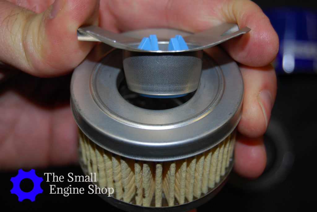

Another view of the STP Oil Filter S6607 bypass valve and where it fits into the paper filter end cap.
STP Oil Filter S6607 bypass valve and where it fits into the filter paper end cap. There was a lot of play between the bypass valve and end cap. Roughly .03″ or 0.8mm.

STP Oil Filter S6607 outer side of the base plate. You can see the base plate has 6 small holes for the motor oil to enter the oil filter.
STP Oil Filter S6607 internal parts assembled, and how it is constructed inside the filter housing
